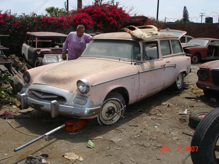

Mike do you have any pictures of the car you mentioned?
Re: Parts for 55 commander wagon
2015 Jul 07 Tue 5:58 am
Yes, I have some pictures.
Give me a little time, I trashed my back Saturday morning, so I haven't done much.
Also, forgot to say, the hood is now gone, well...most of it. All but one side of the grill chrome is usable/rechromeable (one indicator frame has a crack). Bumpers are usable. The engine is there but missing the carburetor and distributor. The dash is there and complete. Front suspension/steering is there and complete.
2015 Jul 12 Sun 6:33 pm
This is pretty much it. But as noted, the right quarter panel skin and the hood are gone. The front floor needs replacing, the top has dents from the parts sitting on it.
The dash is there and complete, the chassis is complete.
Any other questions, let me know.
