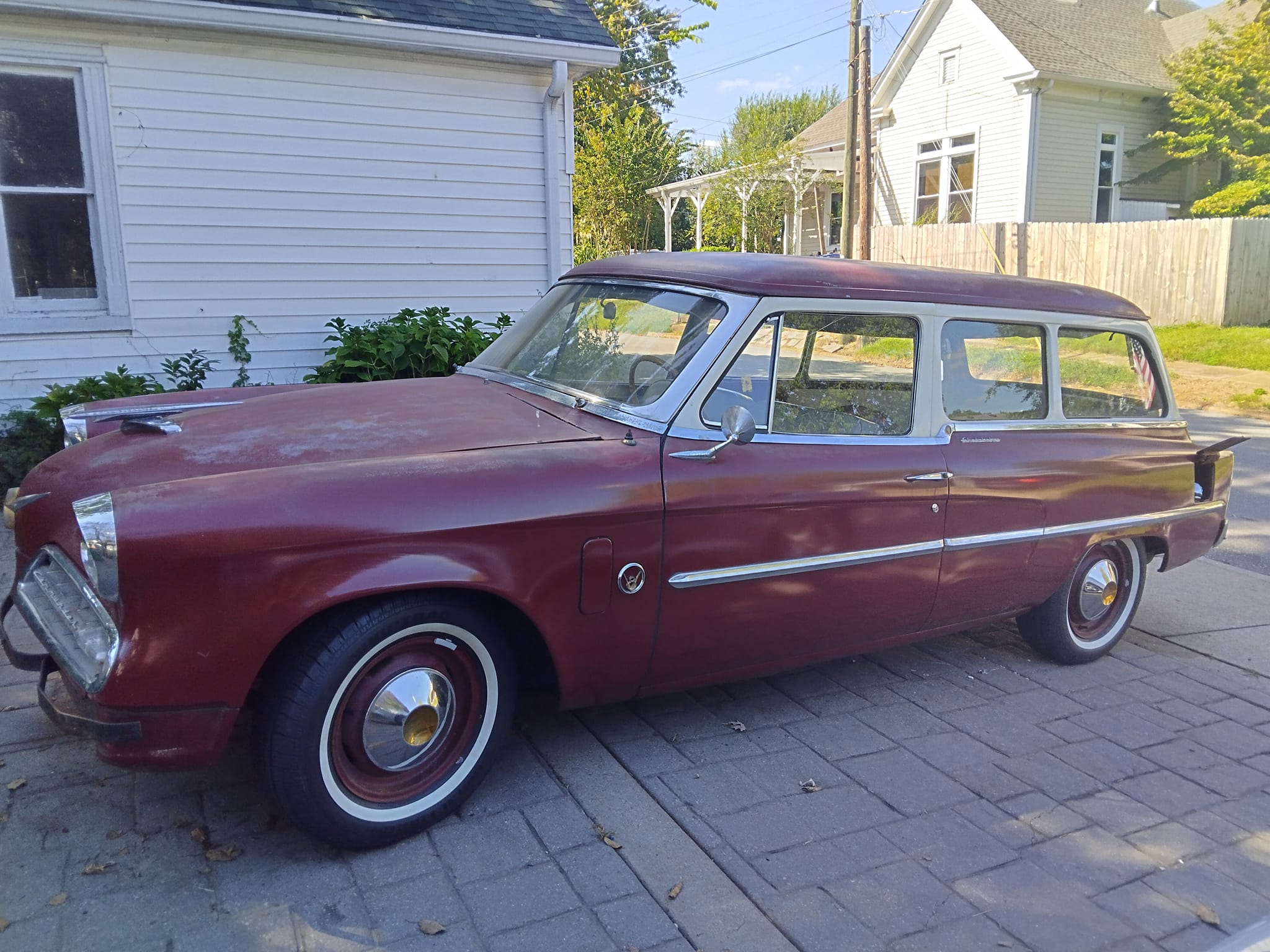

Under construction
2023 Nov 19 Sun 4:45 pm
conestoga left.jpeg (402.94 KiB) Viewed 1332065 times
Re: Under construction
2023 Nov 19 Sun 4:47 pm
Tried to post a photo of car stripped to bare metal, but I guess that was too much for the forum to handle...

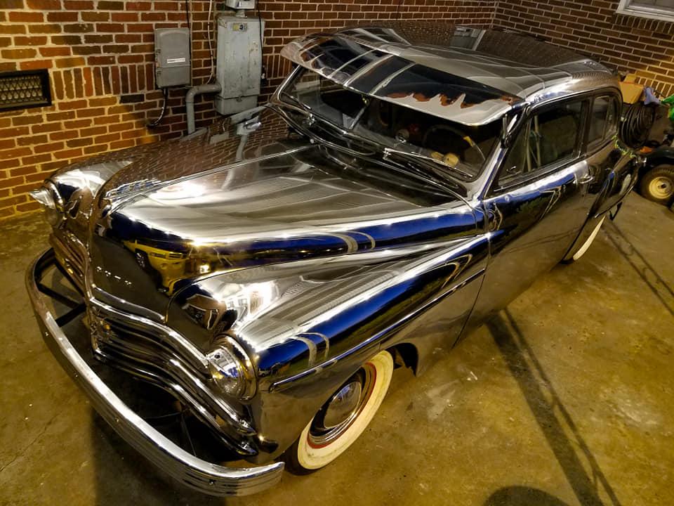

Yeah, that would be interesting. A lot of high end cars get taken to car shows, in their "metal finished" state. They spend a lot of time in bare skin. The guys doing the metal finishing today are true artists.

I actually thought about stripping the car, polishing it and leaving it that way. My wife vetoed the idea- "That's ugly". This is the car I showed her as an example. Good thing I didn't show her something unpolished!

Yeah...have to agree with your wife ! She has good taste...in cars anyway !
Imagine driving down the street on a sunny day, and having the sun bounce off the hood and into your eyes...while going down a straight road. The blindness could last for a long time.
