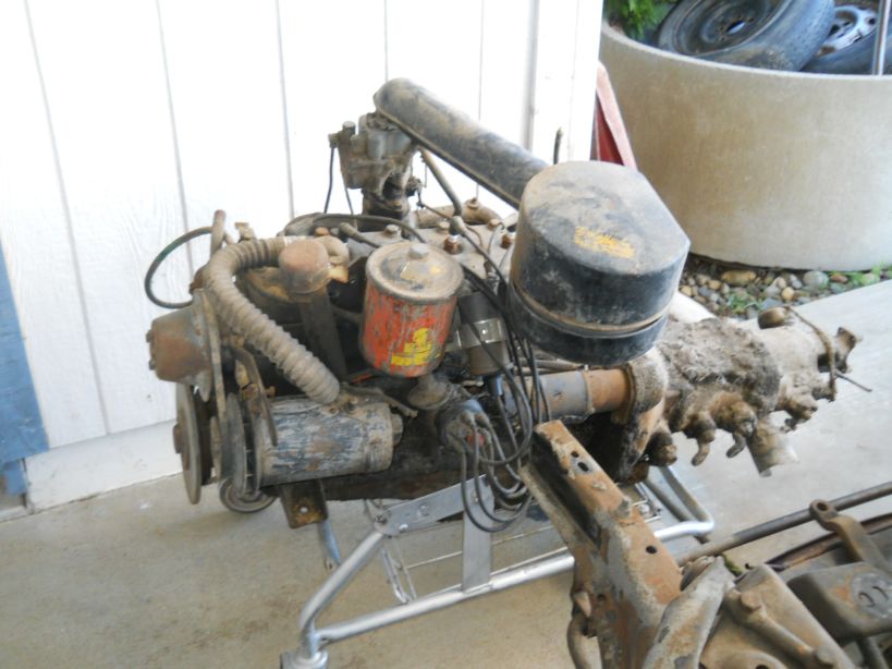

Motor and trans came out this afternoon. Did not take long and was much easier than pulling the V8 out of the cruiser
Much more gunk and dirt to be cleaned is revealed!
Here the motor and trans wait to be picked up by its new owner. Lots of gunk for him to clean off too!

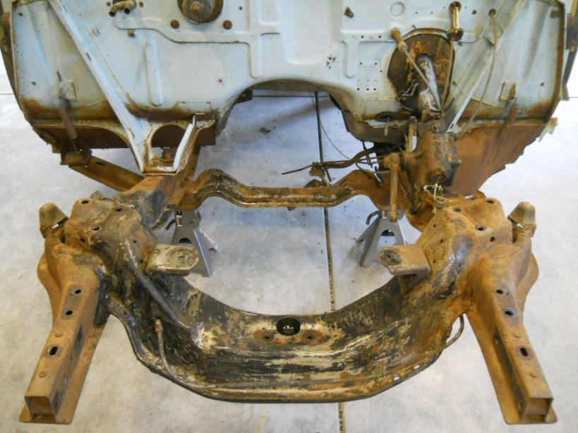

Still no pictures, but the Dana 27 from the wagon is now bolted under the Cruiser, and the Cruiser TT Dana 44, 3.31 is ready for clean up and paint. I think I will change the lube and put new gaskets and pinion seal while it is out and easy to work on. Next step is to pull the front suspension off the Conestoga.

Well I finally got back to work on the wagon. I have been doing projects on my red car and around the house. Today I removed the control arms and spindles so I can put them on the donor Cruiser when I pull the suspension off of that. Next I will remove the steering pieces. All of this is in preparation for cleaning the front part of the frame and painting it before putting it back together.

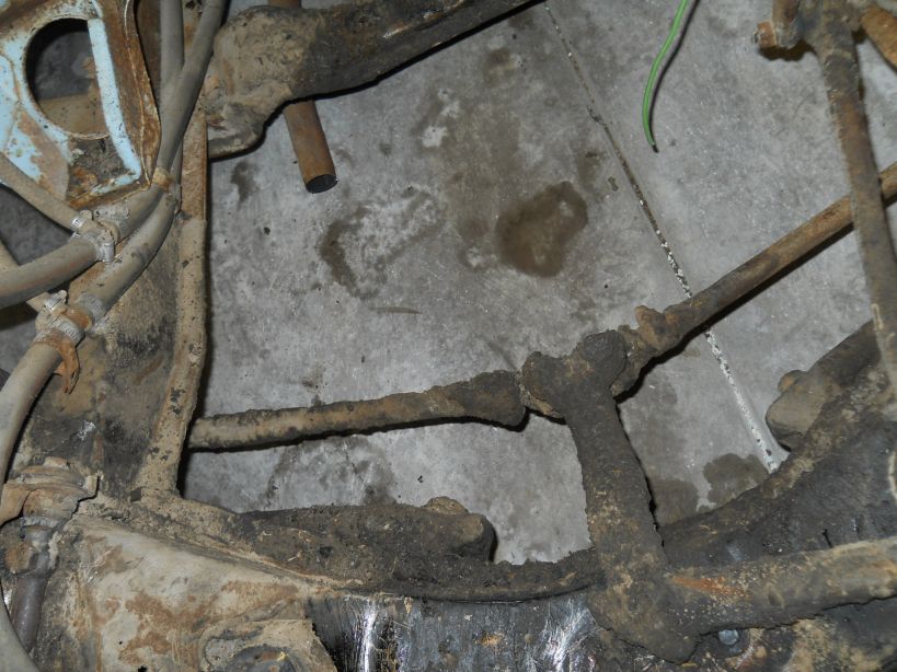

Got the rest of the steering removed and scraped some more gunk. Still some clean up to do then paint time.

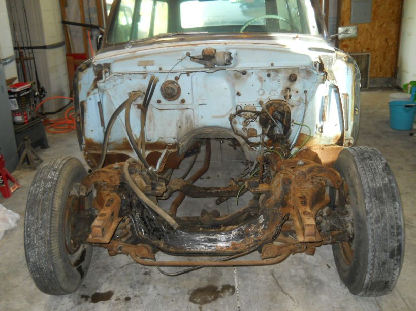

Got the new bolts and nuts, cut them to length and assembled the springs. Put the 44 in place and got everything bolted together. Carried 8 tires, with 6 wheels to my friend Mel's shop and used his tire machine to get 4 tires that will at least hold air. Installed two on the rear then used my floor jack under the front and rolled it out under the car port. Tomorrow I will go after the front frame with the pressure washer and wire brush to get it ready for paint. I picked up some good chassis paint from Eastwood that should meet my needs.
