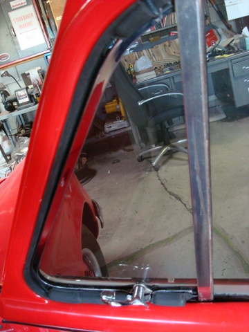

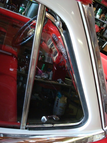

Postby Studeblu » 2010 Apr 12 Mon 8:47 am
OK I finaly got around to installing the vent window rubber in my 54 Conestoga. It is vent rubber for a C-Cab truck.
Not perfect but better than nothing.They leave a small about 1/4" gap at the top and the bottom.Ill try to post a couple pictures.
