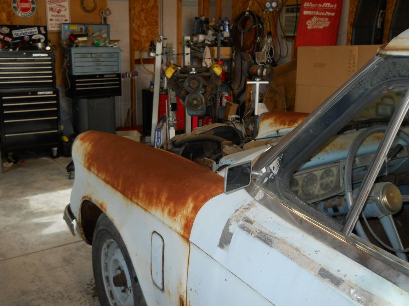

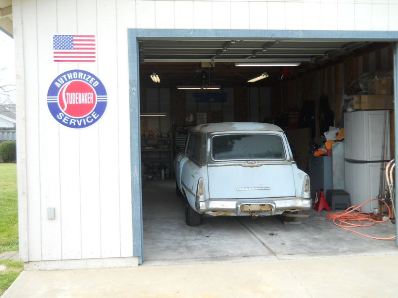

Moved the Conestoga into the shop today
DSCN2083 - small.jpg (119.85 KiB) Viewed 122538 times
And introduced it to its future 289
Later today I will begin removing the front sheet metal in prep for pulling the motor and front suspension.

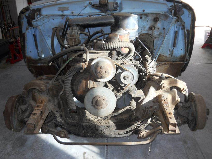

Found the original Body color label under the glove box today. Two tone, Vienna Blue & Nocturne Blue. 2522 C Nason, WYL - WWE W-F-Y-C-K Models
Removing front sheet metal. Came to the conclusion that this car has been driven a lot on dirt roads. Very lucky there is not more rust on the fenders than there is. Dirt was piled up under the headlights. Had to use a nut cracker on the nuts holding the core support and fender to the frame. Driver fender is off. Next step is getting the climatizer out of the passenger fender so I can remove it.

Postby Stu Cool » 2013 Jan 12 Sat 9:25 am

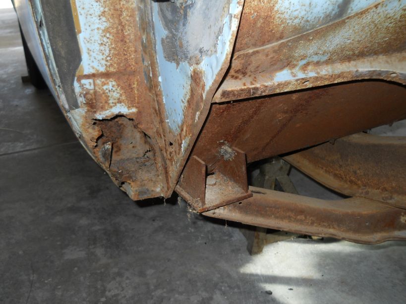

Removed the front sheet metal yesterday
Found some rust in the passenger door pillar I will need to repair.

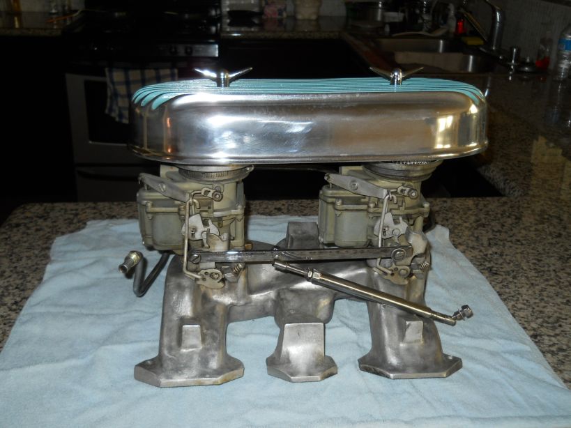

Fedex guy brought this nice eye candy. Hope it will fit under the hood!
Next step is to push it outside and go after it with the pressure washer. Then the old flat six comes out.

The intake assy. looks nice..

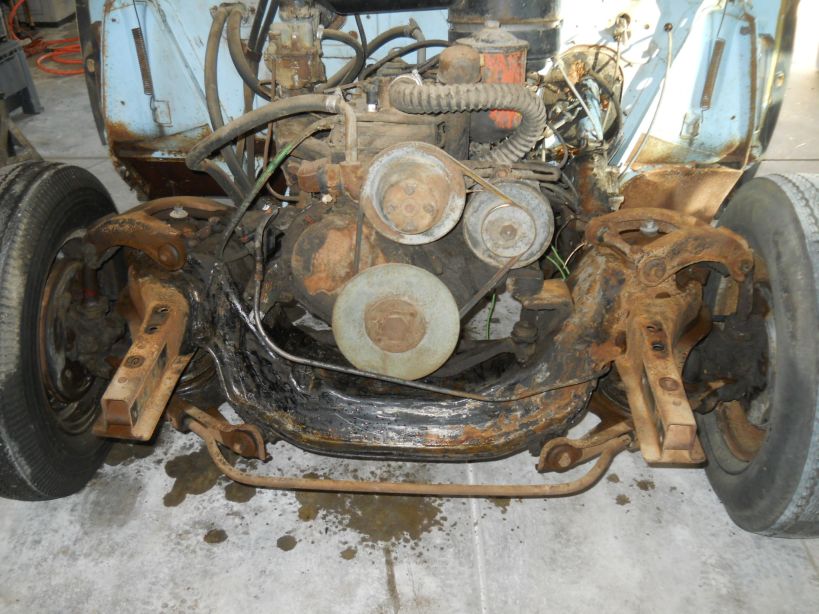

Postby Stu Cool » 2013 Jan 17 Thu 5:10 pm
Scored some better front fenders. A little rust and the metal on the bottom of the passenger is getting thin, but much easier to fix that the ones that came on the car. And the battery box in intact and not corroded!

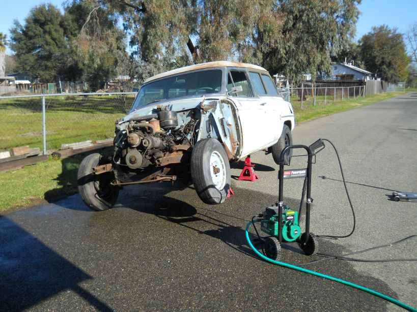

Today I attacked the build up of dirt on the frame and suspension. Also jacked the car up high on one side and took the pressure washer to the under side. Man that is some hard clay under there. Scrape, pressure wash, scraper, pressuere wash; repeat. At least it was a nice day to get wet.
Here are the results, still a lot of gunk on the motor, but not worried about that. It is coming out in the next few days. I'm giving it away and the receiver can worry about the dirt.
