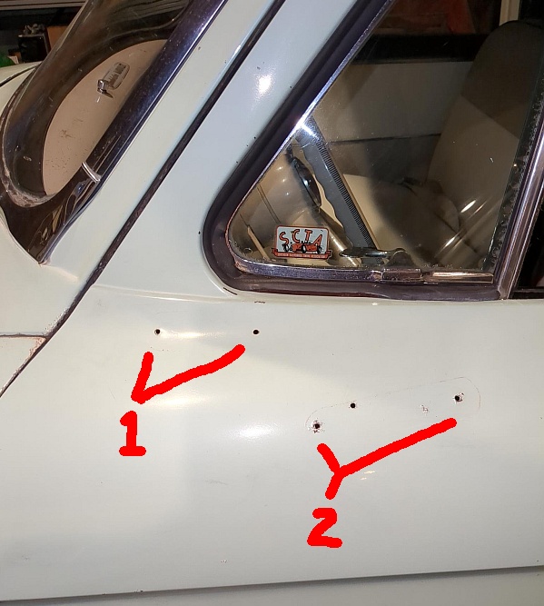

I'm trying to slap a stock mirror on the drivers side of my 54.
I'm guessing the #1 holes in this pic are the stock mirror position - but the body is quite concave in this spot.
Would the stock mirror here have a convex base?
Spot #2 is where my 16 year old dumb ass self put some dorky/sporty aftermarket mirror on when I was in high-school.

Re: What is the correct stock 54 mirror?
Postby Mike » 2023 Oct 02 Mon 10:59 pm
The SCTA decal is cool !!
I'll take a look at my cars tomorrow.
Actually, from memory...the two holes starting at the rear, #2 location, and the forward unmarked hole "looks" to be the correct locations.
But yeah, I'll double check tomorrow (Tuesday).

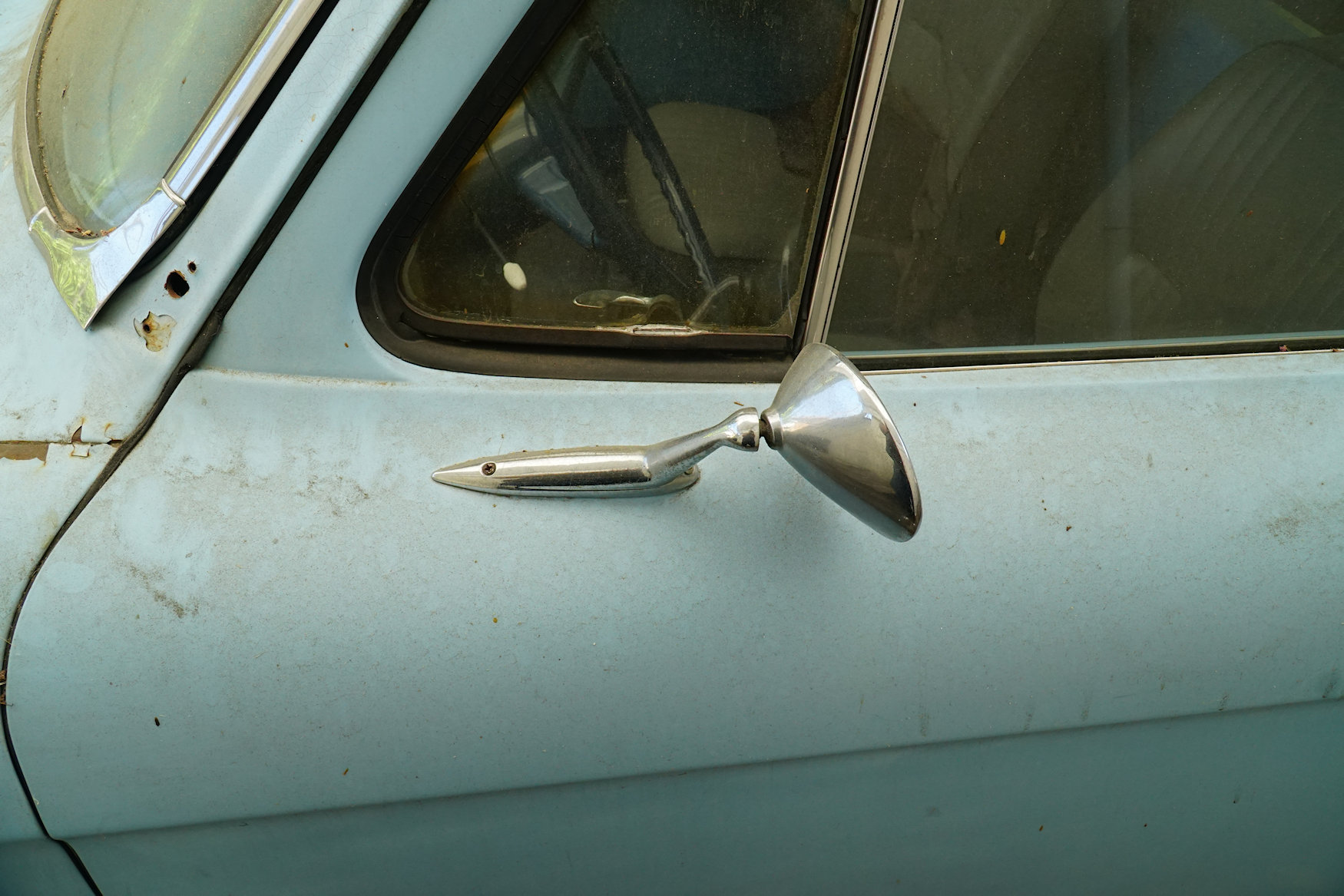

Postby Mainstreetprod » 2023 Oct 03 Tue 5:58 pm
Here's where mine is, looks factory stock
conestoga left.jpeg (402.94 KiB) Viewed 924555 times
Postby BRIZ » 2023 Oct 03 Tue 11:21 pm
Mainstreetprod wrote:Here's where mine is, looks factory stock
oh nice - thanks!
yours looks like the AC-2340 - i'll try to order that one.
the other AC-2728 was not in stock at Stude Int.
(their site said the AC-2728 was in stock but they called me and said no can do)
i like the looks of the AC-2340 like yours better anyway.

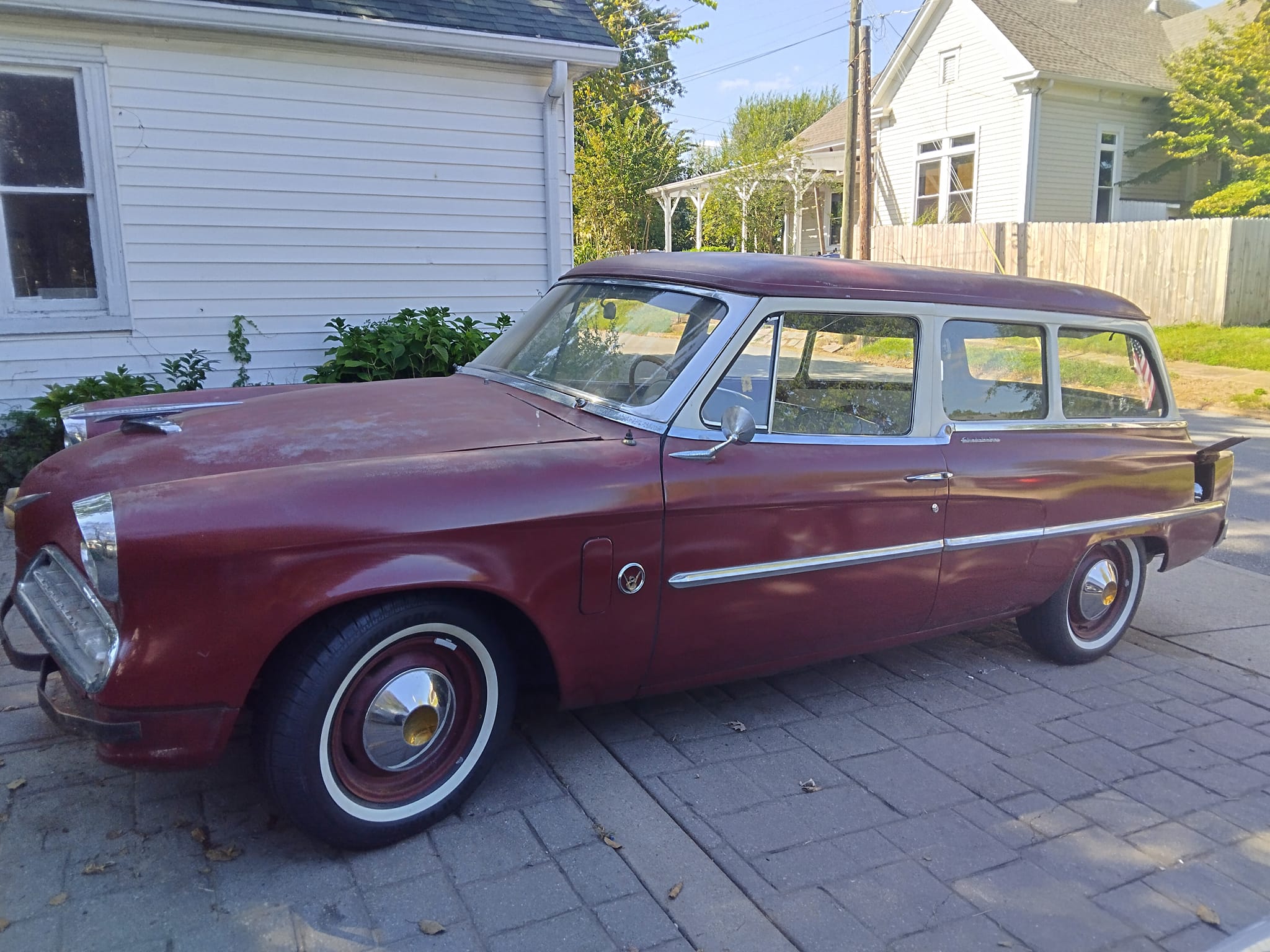

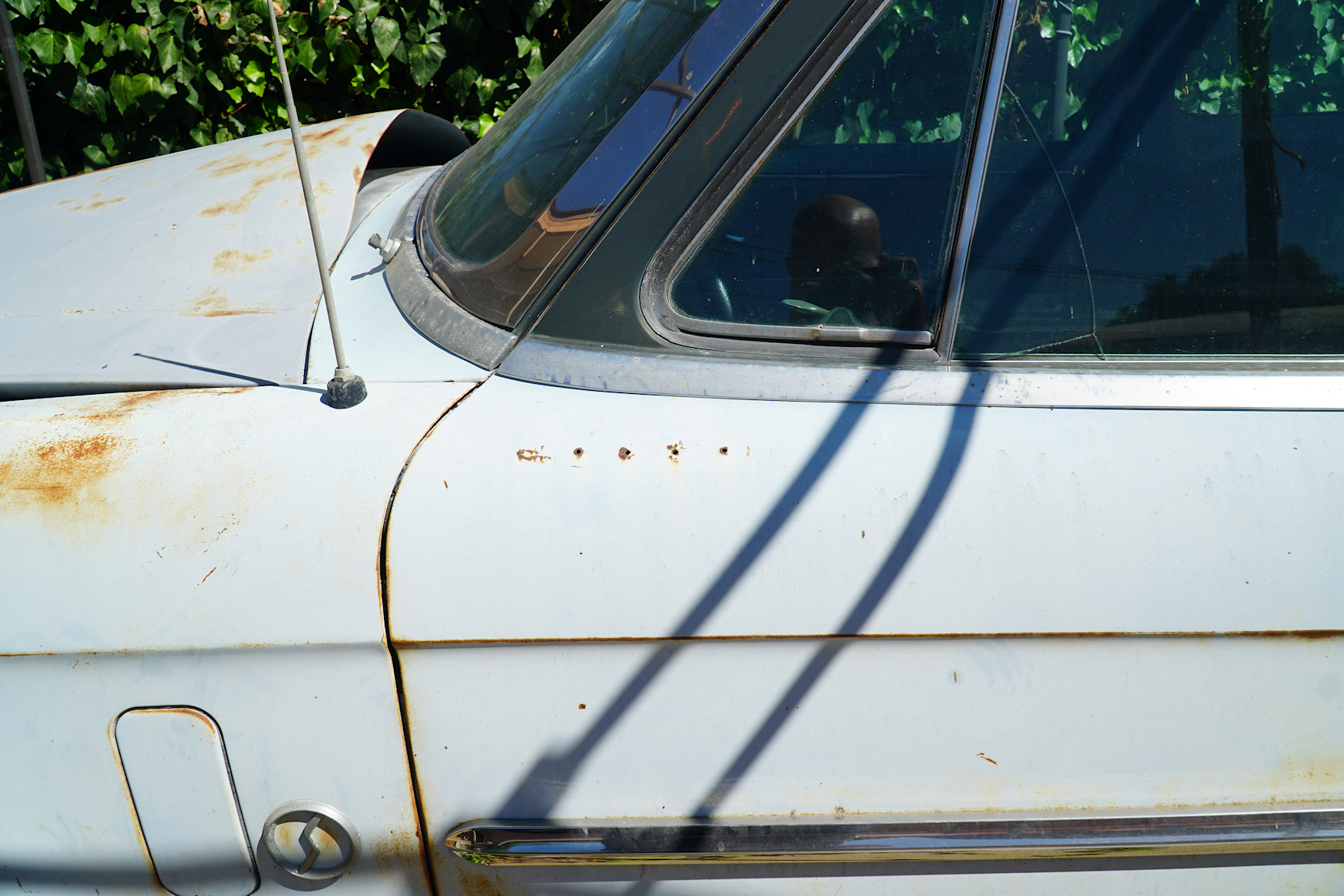

Postby Mike » 2023 Oct 04 Wed 1:55 pm
Shots of both my 54 wagons. Yeah, both severely need baths !!
And shot #2, don't know which is factory, but, they are inline as far as height on the door.
By looking at the mirror location, of the four holes, it looks like the rearmost holes are factory.
BUT...in my Stude (and others) experience, out of 10 Conestogas...i'd be willing to bet four or five would be in different locations.
